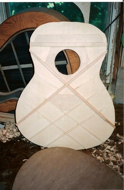

When it came time to design our bracing patters Sergie took us through the pros and cons of the different designs. I really liked the ideas behind the lattice type pattern so I decided to give it a try. This is a picture of the design I came up with on the course.
My first top
I was really happy with the sound that the guitar had when it was done. It had a crisp and even tone with good sustain. So I came home and decided to keep working with the same design. I braced a few guitars pretty much identical to my first one.

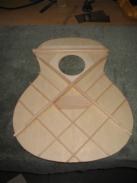

After a while I began to experiment a bit with the angle of the braces. For a While I built with all the braces at 90 degree angles. I think I remember reading that Grit Laskin uses a 90 angle on his X brace so I thought I would try it.
It looked something like this.
These guitars sounded good so I built a few like this. About 10 months ago I took one of my guitars around to a few of the high-end guitar shops in the area to get some opinions. One repairman I showed it to thought that my bracing was a lot heavier than it needed to be and he encouraged me to try lightening the pattern. He showed me inside a bunch of vintage Martin and Gibson guitars so I could see what some lighter designs looked like. A lot of those old guitars are braced a lot lighter than I would have imagined. So I went home and decided to give a lighter pattern a try.

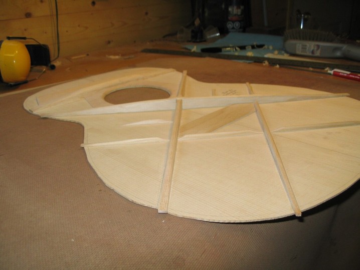

This is what I came up with.
Wow! What a difference it made. The guitar had all the great tonal characteristics of my previous ones only magnified. The guitar was a lot more lively. More volume, sustain and a sweater tone than my previous guitars.
Another luthier suggested that I might try scalloping the braces when they intersect one another. I thought I might as well give it a try.

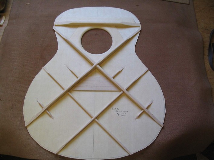

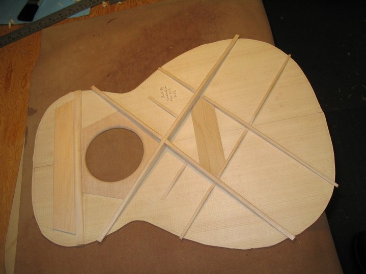

And this is what my current pattern looks like.
I’m not really sure that this can be called a lattice pattern any more. It is probably more of a double X design. The dimensions for the smaller braces are as follows. 8mm x 4.5mm for the taller which runs on the bass side of the top. The smaller brace is 5mm x 4.5mm and runs on the treble side (sorry to all you who work with inches). I also widened the angle of the X to about 100 if I remember right. This guitar is not finished but I am hoping to have it done by the end of the month. The box is now bound and ready to go, I just have to make the neck. As I tap the top it sure sounds like it is going to be one sweet guitar.
So Todd you might want to try lightening the pattern a bit. I was apprehensive at fist because I designed the original pattern under Sergie’s guidance. But after examining a lot of vintage guitars and other designs I feel that this design is structurally sound.
